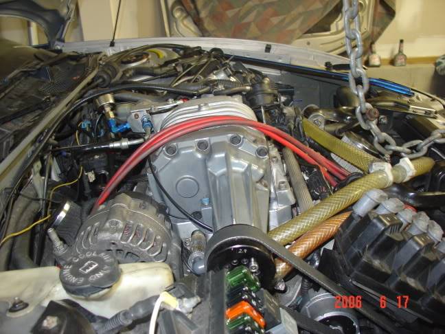

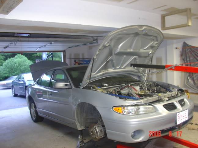

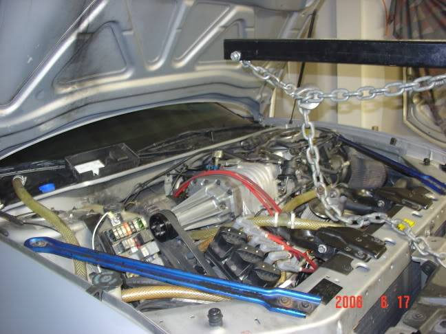

Well, I have been working on my grand prix lately.
I just added
-solid lower motor mount

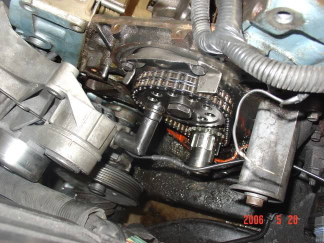

-poly trans mount

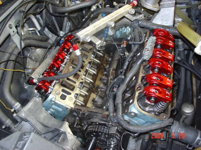

-1.7 aluminume roller rockers
-Ported the supercharger inlet, internal and outlet
-double roller timing chain
-60lb fuel injectors
-North star Throttlebody
This is what it looks like now. I am in the process of putting it back together so I can go racing again. It should have been done, but I have been lazy and also wound up damaging my oil pan in the process. I expect to be hitting 11s this year.
Yes, it is. The "front" of the motor is on the passenger side and it sits at a slant towards the fire wall.
