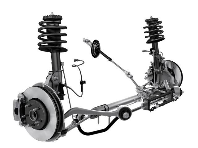

This is an example of a typical strut-type suspension system.
You'll notice that the strut bolts directly to the spindle and that there is no upper control arm. In a strut-type suspension, the strut performs three tasks:
First, it acts as a damper. Second, it acts as an upper suspension locating link, tying the spindle to the chassis through the strut tower under the hood. Third, it acts as a steering kingpin. Because it is bolted directly to the spindle, it has to turn with the steering. The spindle turns on the strut's axis. This also requires a bearing cap on top of the strut to prevent the spring from scraping against the strut tower.

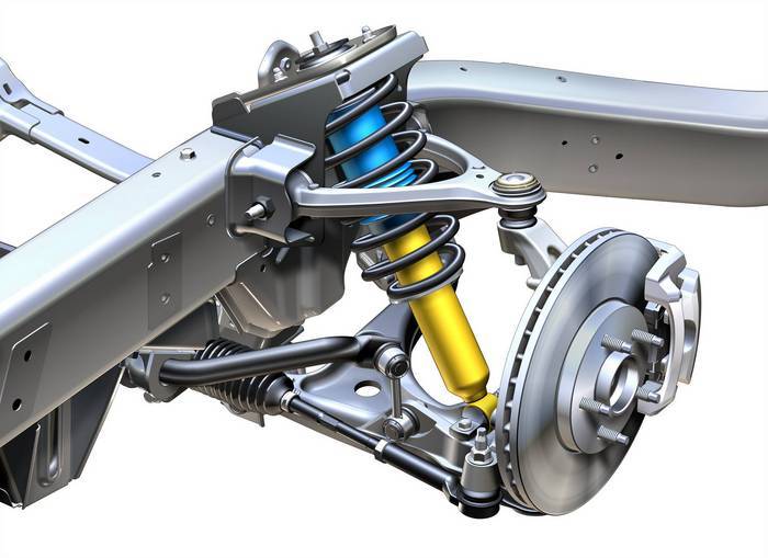

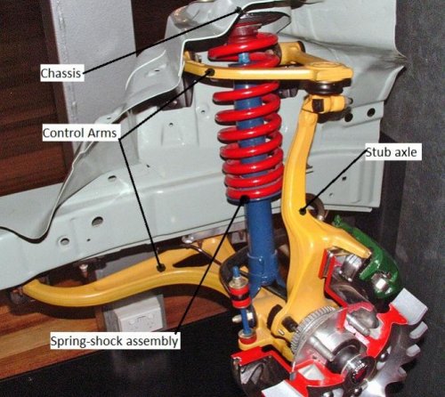

This is an example of a proper upper and lower control arm type suspension as on our Mark VIII's.
Notice the differences? In an UCA/LCA type suspension, there is an upper control arm and the shock mounts directly to the lower control arm, not the spindle. In a UCA/LCA suspension, the shock performs only one task, damping. That's it. The upper control arm provides the upper location for the suspension, and the spindle itself performs as a steering kingpin.
