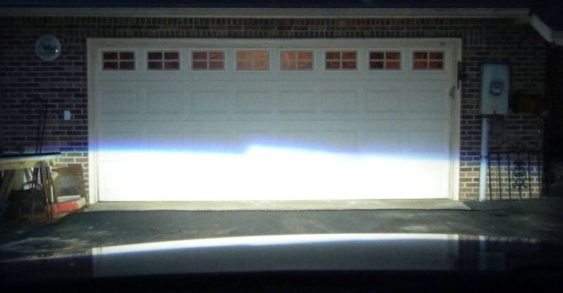

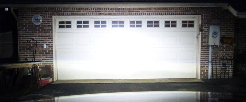

After a dozen different tested China bulbs of various types, I'm thinking this is about as good as its ever going to be with latest/greatest refit projectors.
I use the same bulb for low beam and high beam. These bulbs are 3 wire plugs as seen in the picture. The connector tab near the table is ground. The tab facing toward the bulb is low beam. the tab facing up is high beam. Use only the low beam tab in both your low beam and high beam ports if you want to LED both but it will take some drilling modifications to get these in the car light housing. I'v described it as best I can in the article.
