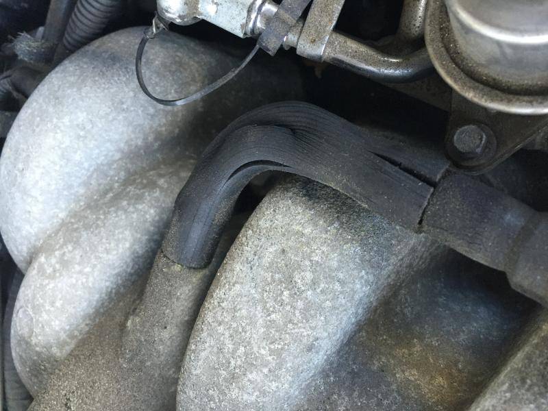

that is the hose im refering to, furthermore i reconnected the maf and reset the mil's/cel. start the car its idling rough and still stalling in gear.
That hose is shot, way shot. Could easily be the issue. In fact most of the soft rubber stuff looks really bad.

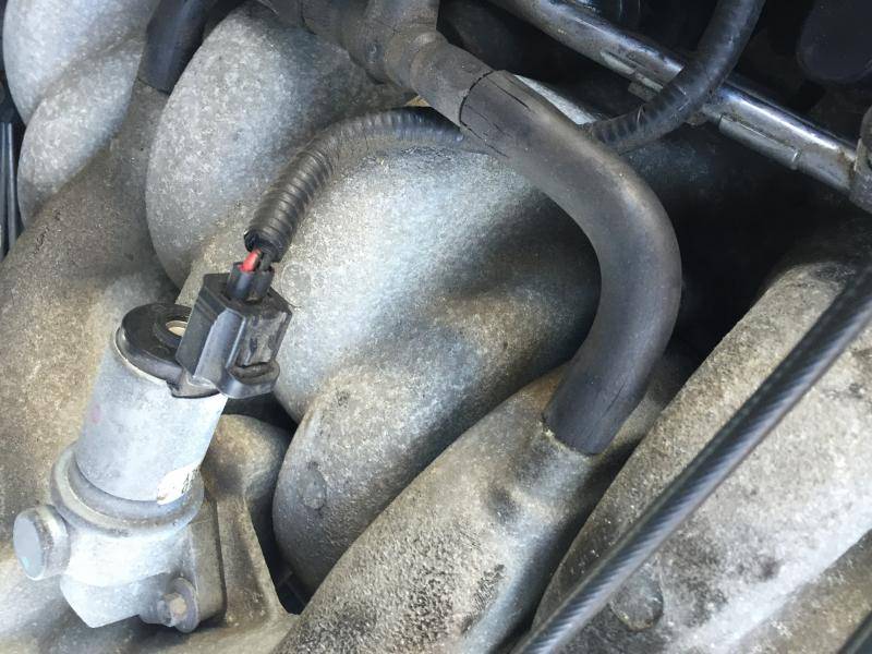

That last pic is the IAC (idle air control valve). Remove and clean for safe measure. It will not hurt to hit it up inside with some lubricant after. Just never use silicone spray lube, its hell on the cats.
Trying to find out. What are those hoses, how to remove and replace them. As they appear heat shrunk on. If that is the case I just need to know the kind of hose to acquire.
They are just stuck. Its a high temp rubber hose. You may still be able to get them form Ford. For now you may be able to use the flexible clear stuff from a hardware store. That stuff never bends well so you may have to put extra length for curves to sorta look around itself. Or you could do short pieces with a barbed L fitting (plumbing section). Lots of temp options really.
That first pic is definitely a problem, likely THEE problem. go to the auto parts store and get a couple feet of 3/8" fuel line will do the trick. You do not need fuel injection hose, plain ole fuel line. May not hurt to get some 5/16 - 1/4 - 3/16. It always comes in handy. I typically have a couple feet of each in my box at all times. You may only need a couple of inches here and there but at least you have it. With the age of our cars one of the first things we should always look at are the rubber products. Whether it is under the hood or the suspension. Not quite the root of all old car evil but right up there at the top.
