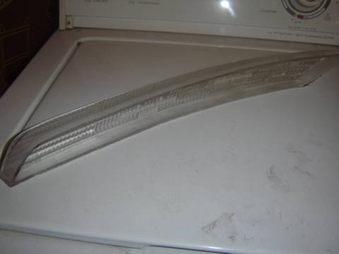

It helps! It doesn't help by itself though. Cut the lenses off, take the metal piece out (yes it is metal) Get some chrome rocker panel tape from Pepboys and very carefully cut it to fit where the chrome has burnt off, Clean the inside of the lenses with rubbing alcohol, put it back together again by melting the lense back together at severel points with a decent soldering iron & finish by applying clear RTV silocone around the cut.

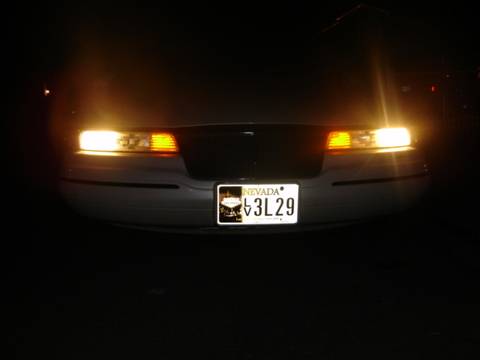

This works, I just did it to my friends 94. Check out the pics! My 95 on the left with BRAND NEW HOUSINGS & HIR BULBS! His 94 on the right with ORIGIONAL HOUSINGS that I refinished.

Thanks! I will try to write something a little better up with more pics. This is by no means a perfect solution but it does work out pretty good! If you don't have $400+ bucks to fork out & you are handy with a dremel then it might be a good solution for you.
