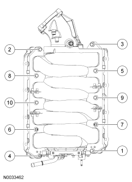

This is the intake manifold. This is what you are talking about?

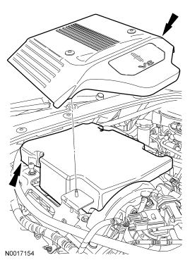

This is the cover. It's only functions are cosmetic and noise reduction. The engine runs just fine without it.
