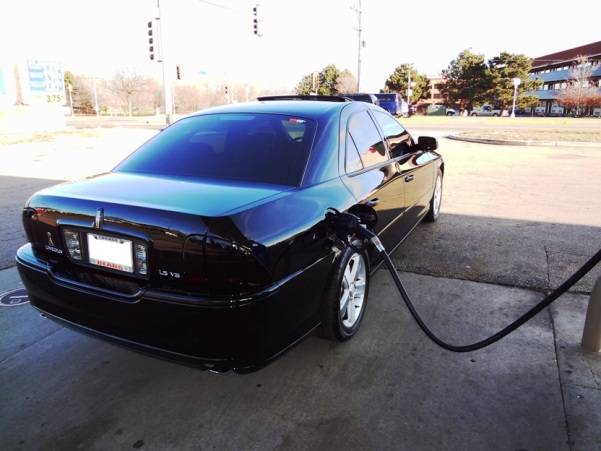

VHT Nite shades seems to be the most common spray type tint. I have several coats on mine so it is very dark. The tail/brake lights are still easily visible.
JRT1418: A smidge darker than I would do mine personally, but those tails look stellar dude! Love the colormatched rear surround as well. Definetely inspired me to do mine in the near future. How many coats do you have on yours? Sanding between coats? Any tips? Thanks!
Be sure to get LED bulbs or else your tails will warp with the heat from the filament bulbs trapped by the tint .
Also, if you think you screwed them up doing it, give them a second chance. I lived with mine looking hazy/orange peely for about a year, then I discovered the awesomeness of wet sanding and polishing them.
yup, the best part of painting them, is that if you mess it up, you can always sand it off and do it again!
