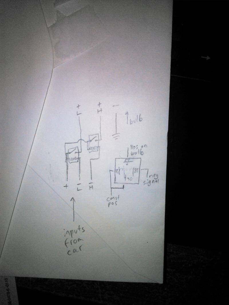

I think this should do it for you. 2 relays per side and an new ground connection. Clip all 3 wires at the plug. Connect the positive wire to pins 86 (coil) and 30 (relay switch). Connect the switched negative signal to pin 85 (coil). Pin 87 (relay switch) will now put out switched positive. Repeat 3 more times.
Connect the appropriate switched positive outputs to the former switched negative wires on the bulb connector. Connect the new body-negative to the old positive wire on the connector.
You'll probably need load resistors bridging positive to high/blinker/major negative to cancel the bulb out warning.
Thanks for this LSFrank. However, this looks like Chinese translated into Portuguese translated into a dead language to me. I'm like a girl when it comes to electrical stuff. I know how to plug stuff in and turn it on and off. That's about it. LOL

I'll try to make a better drawing later on a real piece of paper, instead of on an envelope. Regardless, look up "relay pinout" and match wires to numbers
1st gen is different from 2nd gen too FYI
I'm not sure what's different, but for reference, I followed the labeling on my blinker socket and made some guesses about wire color vs. polarity. "Major" and "Minor" have black wires with stripes. "GND" has a red (ornage?) wire.
still waiting on upgraded diagram now that original posting has no diagrams anymore (that at least i kno i cant see)
