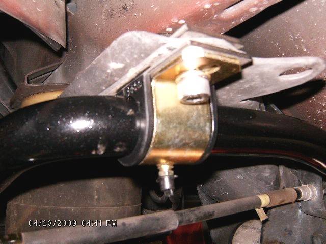

I installed the 1 1/8 bar from Addco/Shox, I used the original brackets but with the included poly bushings.
The only snag for me was that it was hard to get the bolts started into the mounts with the new fatter poly bushings.
With my cheap tools I used a clamp to help sqeeze the braket closer to line up the bolt until it was started.
Guess thats not your problem, but using the original brakets should work.

Or, you could use Energy Suspension Greaseable Bushings as I detailed in this post on SCCoA.

Read the post I made on SCCoA, you have to make the plates that I did to install them.
It's NOT a bolt-on.
