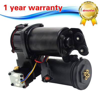

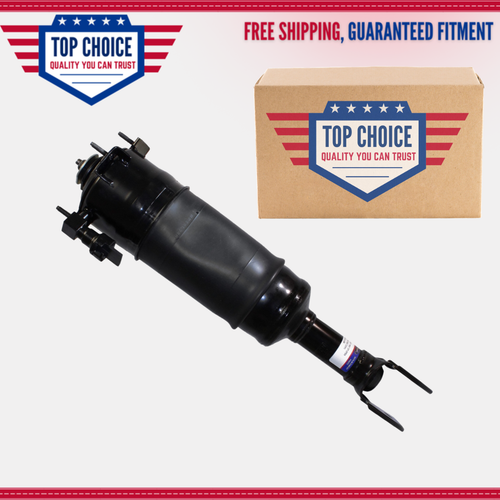

With new front air struts, new rear bags and even the pump so inexpensive, I'm surprised anyone would consider removing the air ride. I think what isn't considered is that comparisons are being made form the new springs to the 20+ year old air parts. New air struts/bags make a significant difference in ride/handling to the two decade old original parts, which most leak air.
new front air struts and rear air bags: $299.25 Both front and rear!
if you want you can upgrade to the Westar struts which are a bit more $169.95 each for left and right, but have been well tested here with excellent reviews.
rear bags: $85.00 for the pair!
new pump: $165.43
I would bet with out doubt that the aftermarket air parts will last as long as the spring kit and you will have kept your M8 original (increasing resale value - I would not consider buying a M8 on springs) while enjoying the better ride quality! And you have the option to add an ASHAM8/RAYS switch to lower and raise you M8's ride height at will!
