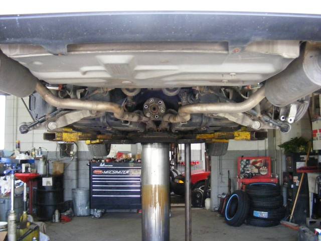

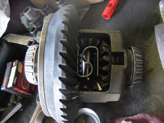

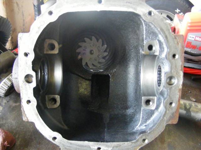

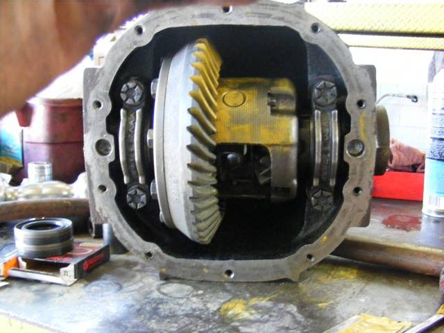

Some of the ones during the tear down didn't turn out so well. these are some of the better ones.
