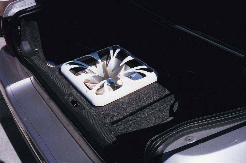

This is the only pic I have. But the spare tire, jack, and things to tie them down are removed. The enclosure takes up most all of the spare tire well. I used a couple layers of some of that egg crate foam to cushion the enclosure on the spare tire well. Only draw back is all that weight back there; I could actually feel it at first, but now I'm used to it. There is someone on here that has (2) 15" L7's. Don't remember how he had it set up though. For 2 of these beast subs I was thinking something like 1 sub in each corner, behind the taillights. It would be a really cool custom set up. I just don't have the time or money for it.
