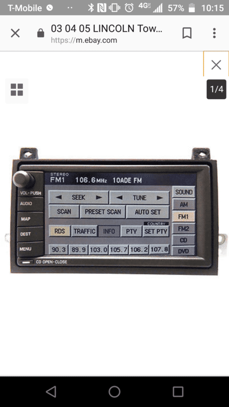

Please search the threads on this. It's completely impractical to add THX nav to a non-nav 2nd gen LS. It's even more unlikely on a first gen.
BTW, besides some large wiring harnesses (that you'll have to hack together to work on your 1st gen), you'll also need at least, the DVD "brain" unit in the trunk, the four channel amp in the trunk, a sub amp and subs (if you don't already have that), the GPS antenna, the rear view mirror (microphone for voice commands), and new steering wheel buttons. You'd also want the THX door speakers. I think I'm leaving a few things out, look for the threads. Way, way, way easier to go aftermarket.
