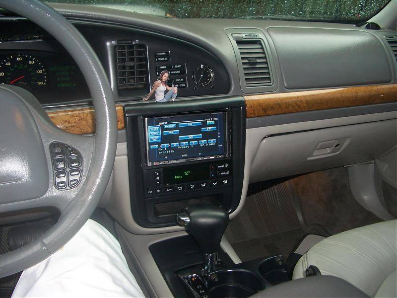

Its about time for me to upgrade my after market stereo in my 01' conti ... and I was wondering if I could fit a double din radio in there? Crutchfield.com dosnt allow me to pick out a double din radio for the car... but i was browsing on cardomain.com and i noticed somebody had a double din radio in, and it dosnt look like he had a custom dash... here's the link: http://www.cardomain.com/ride/2435033
it looks like its fitting in nicely... i would love to have a double din radio like this one, i think it looks alot better.
I'll be honest, I've always wondered this too...it looks to me like the radio is almost a double din. The only thing that might be unusual for sizing is that the radio has a dip in the back of it, which might be there because of ducting or framing of the dash. So the double din might fit perfectly fine from the front, but there might be work that needs to be done behind to make it fit.
Short of taking the radio out and looking, I don't know if there is a simple answer.

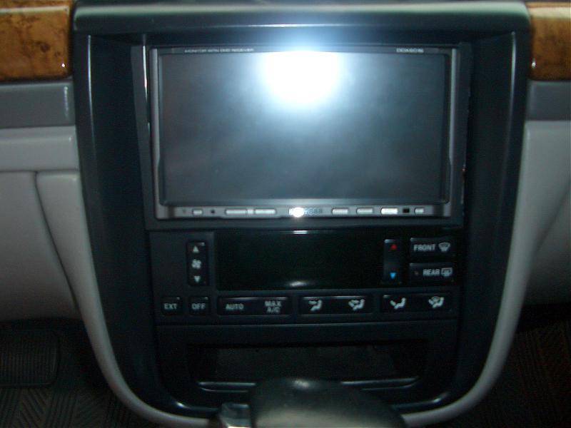

yes a double din will fit. i just installed a kenwood ddx6019 in my 99 continental. i had the same problem, crutchfield said it doesnt fit, but i saw the same car on cardomain. i had to do some cutting though. the cage was actually about 1/4 inch too tall so i took a grinder and had to grind down the plastic on the top of the stereo space. you cant grind the bottom plastic because the ac controls are there. the only problem i had was that there are so many wire harnesess in the back that keep the unit from sliding in all the way so it does stick out a bit, i cant slide it in all the way back to lock it. i also had to put screws in thru the sides of the cage to keep it in. all i have to do now is cut the trim peice to fit.
