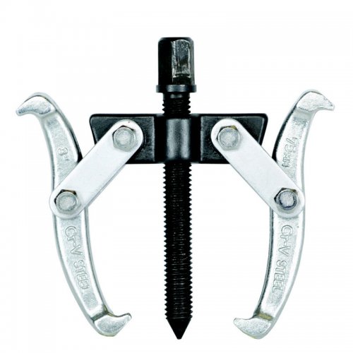

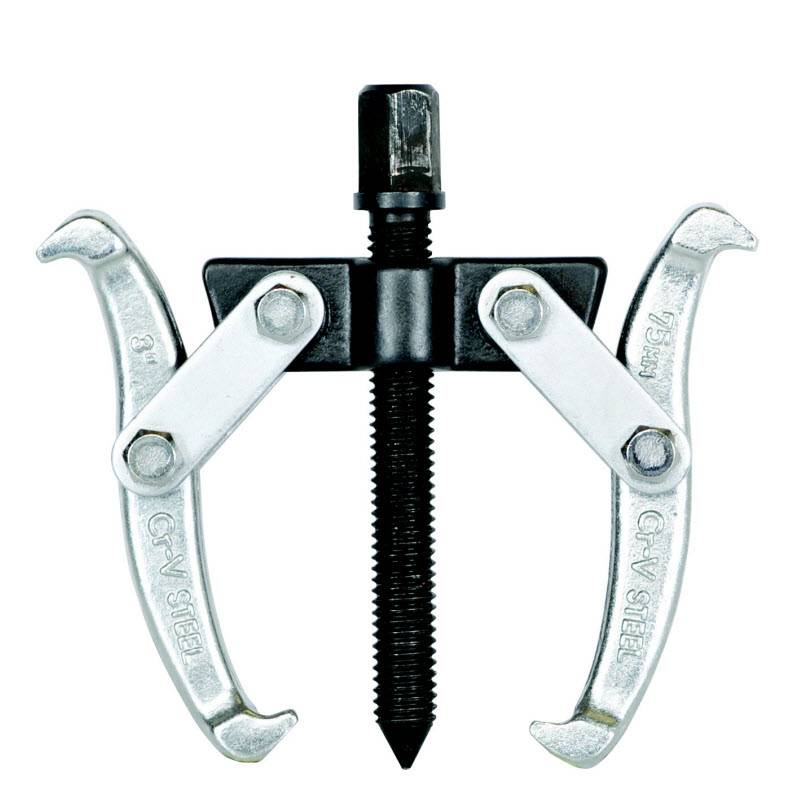

You will need a gear-type puller. A conventional steering wheel puller won't work.
I don't have any official reference but a puller is the right way to do it (rather than yanking the thing). Even with the battery disconnected, I still kept to the side. SPSulley made a thread for clockspring replacement that included this...
Yep. Gear puller, pulley puller, arm puller...
This kind with 2 arms

awesome, thanks for the info. i have a pulley puller just like that so shouldnt be any
big issue.

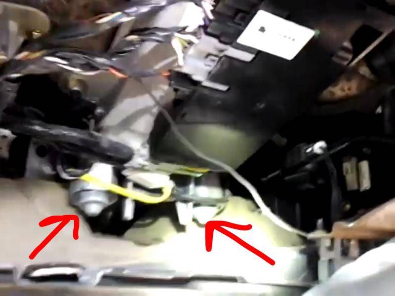

Would the clockspring failing cause the steering wheel to not telescope in and out?
When I first bought the LS. I was seeing that everything worked. I tested the telescope and the wheel came all the way out but it has never, ever, ever, ever wanted to go back in (towards the dash). I used this to my buying advantage of course. But would really like to move it in. I can hear something trying to work when I hold the little adjuster lever either way. The column will adjust up and down. Just not in and out.

I haven't tried hundreds of times. But when getting in the car last night I tried it again. It does move up and down and will make noise when pulling the lever (away from engine)but will NOT make any noise when pushing the lever away (towards the engine).
I have, however, tried pushing the lever away and pushing on the steering wheel, placing the steering wheel in different up and down positions and trying the lever. I have tried turning the wheel either way and pushing the lever. No sounds or not of it even trying to work.
If you get your head down where the pedals are, you'll see two motors on the steering column. You can use the lever to tell which is which. If you can turn the one that won't move by hand, you'll know it is an electrical problem. If you can't, look for a mechanical issue.
Is this what I'm looking for?
Yes, and getting to the shafts coming out of the top of the motor is probably quite difficult.
Geez. Alright. I'll be checking that out when I'm down there then. Thanks for the direction!
