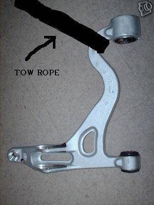

Thanks for the replys. This might or might not affect your opinions. A week before this noise came about, my car slid down into a ditch of snow and the only way out was to get pulled out. Seemingly the only place we could find a suitable tow spot, was right there on the lower control arm. See picture. The car slid right out of the ditch, very easily being that it was all snow. I didn't think it hurt anything. I was only pulled about 5 feet. Does anyone think that that has anything to do with the now very present squeaking? Or totally coincindental? BTW, where on earth do you tow this car if you have to? I cannot find the hooks.

I can't see any way to damage the ball joint with that towing attachment pull point, those arms are stout. You may have ripped the ball joint's boot in the slide, and packed the ball joint with snow. The small amount of grease installed in that ball joint would not take long to displace with water, since the ball joint is probably worn somewhat already with your miles.
