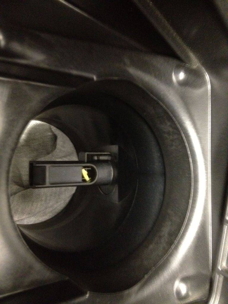

Just got back from doing exactly that - found another thread (via google, didn't find anything helpful through the site search) that suggested the MAF.
Pulled the plug, and it started right up.
Took it out, and found a tiny bit of a butterfly wing, right across the two wires!
Removed that, reinstalled, and it runs perfectly again!
thats what you get for killing one of gods beautiful creatures... MURDERER!!!!!
that looks like an awful big piece of debris that made it through (or around) the filter
Oh man, tough crowd eh?
We don't know that I killed it, may have only maimed it... ok, not sure that's any better...
Yeah, I was wondering about the filter too - really ought to have taken care of this. The rest of the butterfly wasn't on the filter, the filter is really clean still - maybe it's just a little piece that dropped in last time I changed the filter (last fall) and finally made some trouble?
