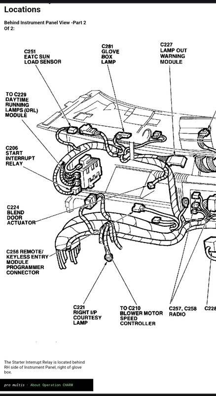

I would like to to check the relay for the ignition but not sure where it is. Does anyone know ? I couldn't find anything in the master manual. I'd like to jumper it to make sure It's the starter first before this old man crawls under the 96 Mark and tries to get that top bolt off .. the one right behind everything else .. so I've heard. Thanks ..

Just an update ... jacked up the car ..crawled under .. and started laughing ... no way I could get that off without a lift. Great engineering on that placement ! Ended up taking it to my mechanic .. well worth the 180.00 for labor ..
