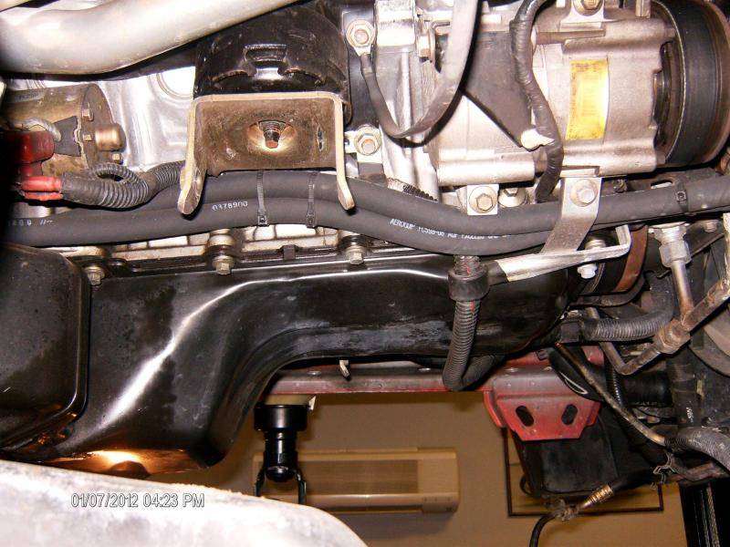

Take a good look at the cable that powers the starter. It runs under the front of the oil pan.

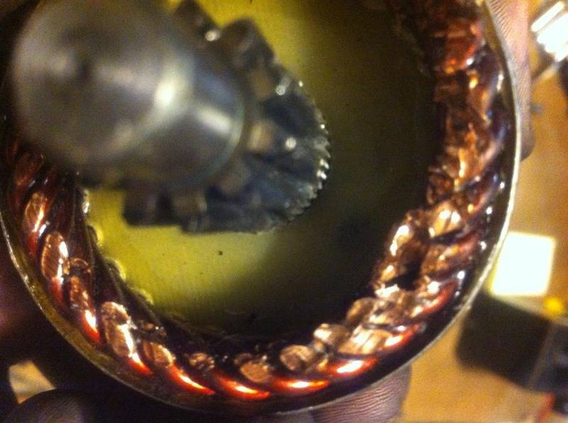

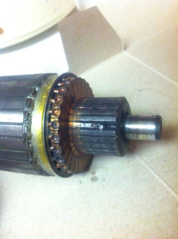

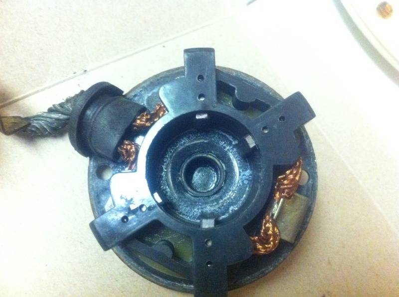

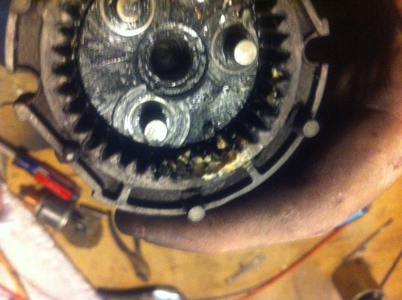

the old parts. you can see how worn they are.
so i bought new parts. then one of the gears broke, damaged the gear housing and destroyed my new armature! damn. got another gear housing and gears from the spare parts half of the garage, and getting another armature tomorrow... sigh. its fighting me every step of the way.
