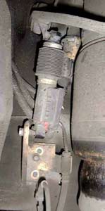

ok so i finaly got some spare time today and was looking around, it looks like the solenoids are there but i didnt see the ride height sensors, anyone got a pic and location of them?
Rear height sensor is located on the drivers side of the car. Remove the wheel and you can see it. It's the thing with the scrunching boot on it, in the middle of this picture.
There is one on each side on the front, remove the wheels, you will see them.
ok thanks. i was under the car last night trying to look, i know i didnt see those on the front but i didnt check the rear yet.
