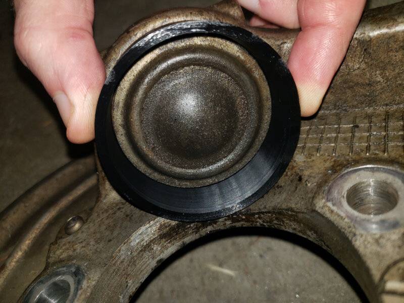

Good deal. I'm going to give it a try with the Harbor Freight ball joint press kit. I took some measurements with a caliper. It looks like the outer diameter of the ball joint is a hair under 2 1/4" so the receiving cup in the HFT kit with the 2 1/4" inner diameter should be perfect.

#4 looks like it should work for pressing out. If I measured correctly, it should be just large enough for the ball joint to push out into it. For installation, the #8 cylinder + the #6 adapter should be deep enough to accept the new ball joint + stud.

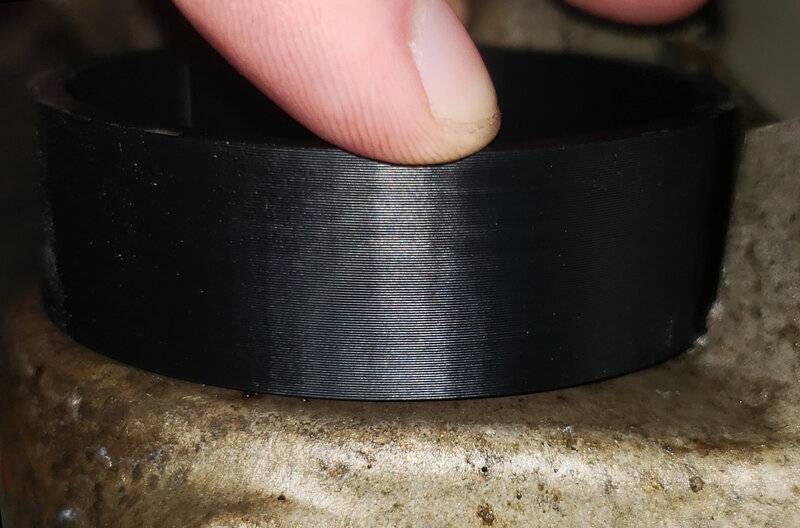

To make sure, I'm going to 3D print a tube with an ID of 2.25" and an OD of 2.5" just to check fitment.

Thanks, that's a good note. My mockup tube is printing. Just eyeballing it, it's possible that the 1/8" thickness of the tube might be too thick to clear the "back" of the ball joint. There's not much room back there. I'll report back after the print finishes.

I think that #4 cup from the HFT kit should work perfectly. It fits around the ball joint and sits flush against the aluminum knuckle. In fact, it settles in there so perfectly it feels like the knuckle was designed specifically for a removal tool of this size and shape.
