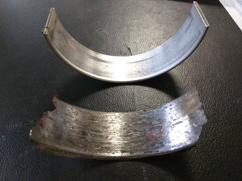

If you ever wondered what a "spun" crankshaft main bearing looks like, here's one of two from my engine alongside a worn but intact neighbor
The other bearing spun itself into oblivion and was just a few shards in the bottom of the oil pan. Boy oh boy is it ever difficult to find crankshaft main and thrust bearings for the 3.9L V8. I've been able to find a good used crankshaft as these two bad bearings did a real number on my old crankshaft. Most of the parts required for a proper bottom-end rebuild of the 3.9L V8 just aren't available anymore. I was able to find new piston rings (Mahle) but almost everything else has to come from a dismantler as hopefully usable old parts. I've to ordered connecting rod bearings used in the S-type Jaguar 4.0L V8 from Terrys Jaguar (thanks to a referral from a member on this forum!)
Piston and Connecting Rod - V8: Terrys Jaguar Parts
... and I've just purchased used crankshaft main and thrust bearings on eBay, also from a S-type 4.0L Jaguar. Terry's Jaguar CAN get these S-type 4.0L crankshaft bearings new, so if the used S-type bearings are identical to my old LS 3.9L bearings then maybe I'm in luck. If you wondering my machinist buddy doesn't want me to re-use the crankshaft bearings from my engine because they were exposed to the fine metallic grit created when my bearings spun to death. I just hope I will have a choice!

If you search recent threads, you'll find that it's necessary to source main bearing shells from England. There are places in the US that do so and carry them, and a search through the internet will find them for you. You'll discover that the going price is between $6 and $10 per shell or $60-$100 for a complete set.
Are you sure your block and/or the main-girdle aren't damaged?

Thanks so much for your suggestions! Surpringly the block and the crankshaft main bearing housings are in good shape. The previous owner must have had good hearing and shut the engine down quickly after the connecting rod bearings spun.
Terry's Jaguar does seem to have the connecting rod bearings available in three sizes and for two different engine series - not for the Lima built 3.9 V8 but for the S-Type 4.0L. They show a diagram for the 4.0L crankshaft with main and thrust bearings indicated, but they don't list them as orderable parts. Do you know if the 4.0L crank and thrust bearings really are identical to the Lincoln LS 3.9 V8?
Other than Terry's Jaguar, I have been unable to find anyone on the internet that even talks about 3.9L/4.0L bearings, much less sell them. Except for DNJ in Chatsworth, but they have discontinued the parts. Any info you could share is most welcome. My plan at the moment is thoroughly measure my existing bearings and then get on the phone with Terry's Jaguar and pray these two engines are identical when it comes to connecting rod and crank bearings.

I've never tried to put Jag bearings in a Lima block, but there must be drawings that show crank-pin measurements. Application call-outs can be very deceptive.
