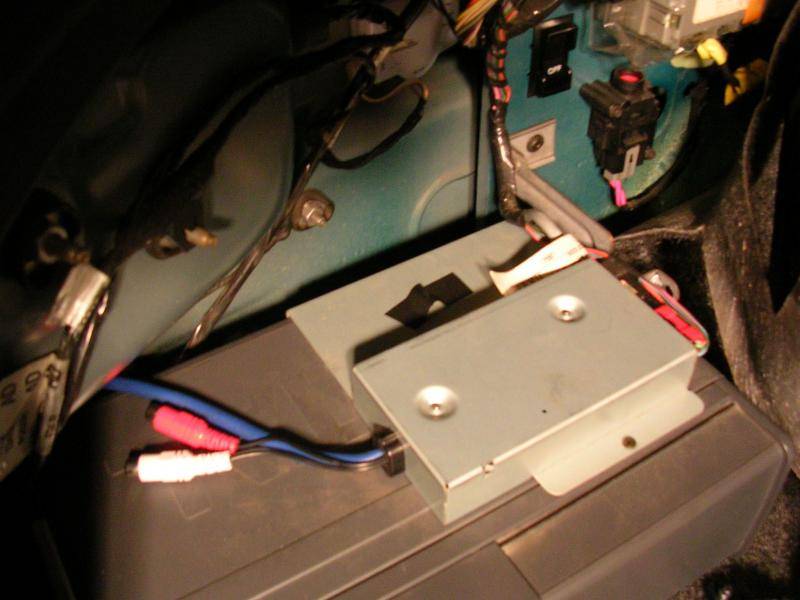

Auxilary Jack on my factory CD player's low level signal module. Allows me to listen to either my iPod, mp3, audio from a portable DVD player or attach my Bluetooth audio receiver to connect to virtually any device with Bluetooth output (iPads, Tablets, Cellphones..etc) wirelessly.
Kept cost as low as possible by using materials I already had in my miscellaneous parts bin. $0.
