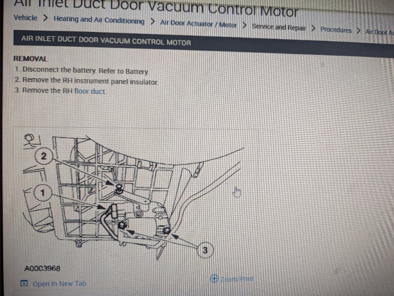

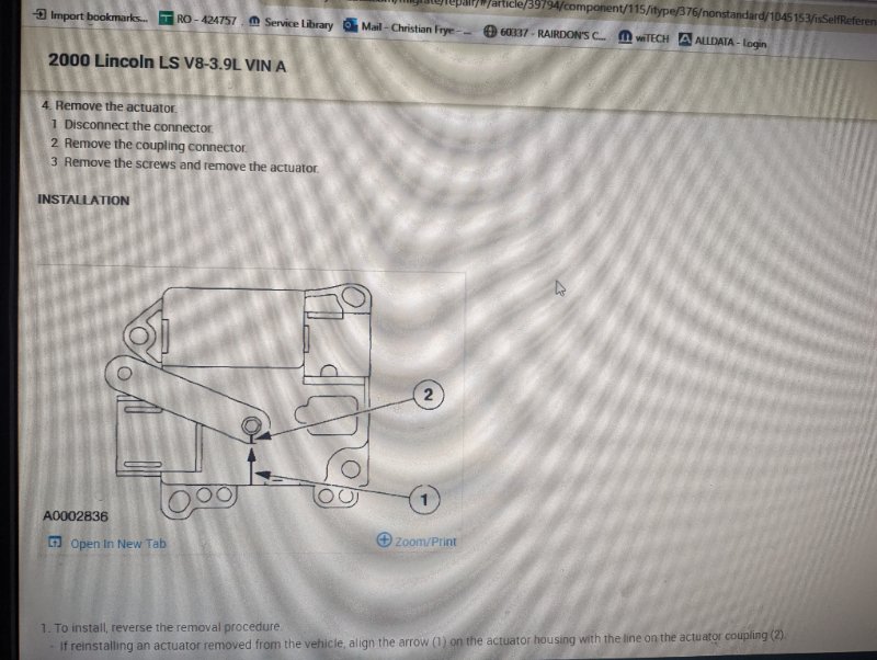

Has anyone replaced the air inlet blend door? My recirculation is non functional and I have a DTC. I'm hoping I don't have to remove the dash.
2000 3.9. Thanks in advance
