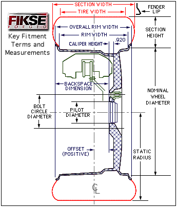

You can't go by the offset alone. The offset is taken from the center of the wheel which is a different measurment depending on how wide the wheel actually is.
This illistration should help you out.

forgive me for being an idot, but still not sure how make sense of that chart
so if i have a 8.5" deep wheel with 40 offset and use a 245/35/20 tire at the stock ls height is it going to rub at all??????

You should be fine if it was under 40 I would say you will probably have some problems but 40 should just make it mine are 42 and lowered about 2 inches full car no problem

I would say yes. I had 245/45/18 with a 40mm offset on a stock height LS; They rubbed with any weight in the back. The 245/40/18s don't. Had I to do it again, I wouldn't go less than a 45mm offset.

Did you check out that calculator mentioned above? It will show you how far out from stock the wheel will stick out.
guys you can say 42mm offset, 45mm offset, 40mm offset all day long. You also need to include the width of the wheel, that makes a HUGE difference. You can run a 34mm offset if the wheel is 7.5" but you cant run a 34mm offset on a 8", include widths too please!
