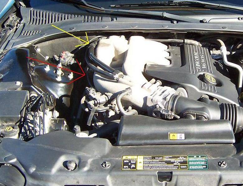

Help guys. After a short drive this morning I pulled into my spot at home and sat for a second gathering my thing in my car. I noticed smoke coming from one of the heater vents and it smelled of oil. I immediately poped the hood to see if I could detect the problem. I saw smoke coming from the left side under the intake manafold (indicated with a red arrow). The smoking lasted about 10-20 seconds and then went away (the car was still running). I fear this may be the coils but that side is very hard to get to so I cant check myself. I have 1100 miles of warranty left but it has been a real PITA to get things done in a timely manner from my dealer.
On a second note the Yellow arrow is pointing at a vacuum hose (I think) that has been troublesome for me. It has come loose several times and will not allow the car to start. This was the first place I checked when I saw the smoke from that side but everything appeared to be dry. Why would this hose keep popping off?

Ok here's an update. I drove for most of the week without noticing anything further on the smoke. Then this morning on my way to work there it was again, and again on my lunch break. I drove one mile from my house and stopped at a light. While stopped I began to smell the smoke and sure enough there it was... in the same spot. I checked my oil level after lunch today and it seems about 1/2 quart too high. Could this be causing the "leak" from some sort of valve or gasket? I am going after work today to have the oil changed (it was done about 1000 miles ago) and see if that changes anything.
The intake manifold just beneath the arrows in the pic seems to be covered with oil. But the intake manifold does not get hot enough to burn it. I am confused... where could it be leaking from? If the oil change does not help anything it is going back to the dealer. Help...

Yeah took it to the dealer Friday morning and when I dropped it off the tech said it looked like a valve cover gasket but he wasnt sure. Turns out all they did was replace that vacuum hose and connector and clean the intake off. He said something about a "pressure regulating hose" but I'm not sure if that was the hose I saw or another one back behind. Either way it seems to be all good. No more bad oil smells and the problem wasnt as bad as I thought. Havent had any trouble since.
