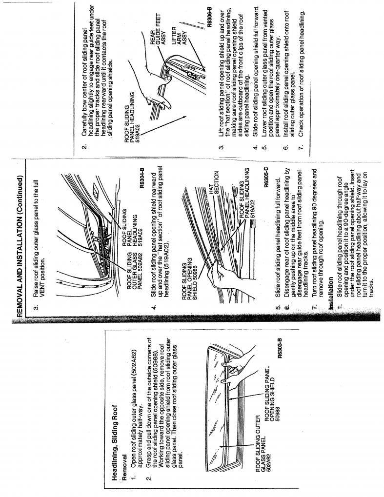

after reading the book 3 times I gave it a try. Success it took about 5 min. The rear guides are plastic with a very strong spring. Hope it goes back in as easy hdliner remove.jpg
