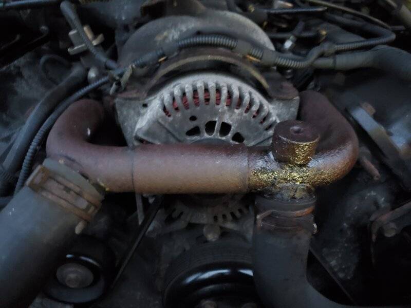

Been doing some research due to my coolant vent cap being rusted. When I bought the car 7 years ago, it was completed rusted. I sprayed it with pb blaster two days in a row and was going to try to remove it. I have found this tool which everyone on yyoutube swears by it.

1. anyone ever get the cap off this rusted?

Wow, never seen one that bad. I think you need to think seriously about replacing that entire upper coolant pipe. It would be a wast of time & money to run down the rabbit hole of trying to get that pipe in a reliably working condition. Think of the heat, vibration and pressure that pipe and its joints are under at 6000 rpm. You need to think about a intake manifold R&R to get a new pipe in place. JMO.
Thanks xtriggerman. I thought of that, with replacing the crossover tube, I will still have to burp the system each time. If I spend a bit more on the vacuum fill tool, I will save time not having to burp the system anytime in the future, not having to mess with the tube vent cap and can still change coolant etc. Maybe I should try to remove it - who knows, maybe the previous owner used anti-seize on it!

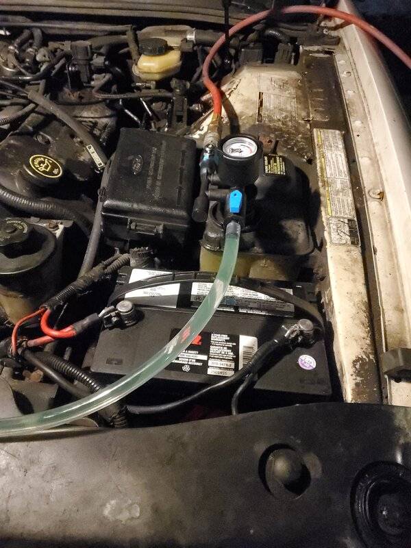

So I bought the below - it was a $142. CAD. The Canadian version is listed as a Uview 550500. you do need an air compressor for it to work, but wow it works amazing! I refilled my m8 in less than two minutes, with no air in the cooling system.

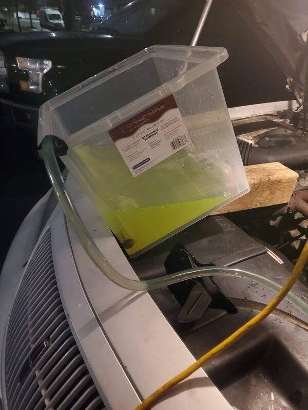

I wanted to create a full write up as I found an access hole that no one else has spoken of for the oil filter adaptor gasket. I have not had time, but see photos of the refill tool. Be sure to have more new coolant to draw from than the system will hold, so you don't end up sucking any air in. The tool even removes the air from the intake hose - which if you watch on utube, everyone misses that and sucks air in the line when they first draw in the new coolant, when refilling.

Yes, the tote holds far more that the 16L or so the M8 does. I saw guys use the Prestone bottles but when moving from one to another when empty, you will get air in the line. The tote is clean and makes the job easy. just make sure the hose stays in the bottom, you can see I taped the hose to the tote.

Yes it vacuums out the air after you drain the coolant. Did you see my burping cap? I did not touch it.
It was dark when I finished and it filled my overflow reservoir to the top quickly before I noticed it reached the cool line. I drained some, started the motor and did see a very small amount of bubbles come into the tank when I revved the motor. I think this is from my battery giving out half way through the refill. You are supposed to leave your heater on with the fan on high. My M8 was sitting for a few weeks as I was waiting for a warm day to change out the oil filter gasket.
I have had zero issues of over heating and the gauge is in the middle just as it always has been, once warm. Motor warms up the same and I have the same good heat as I did before.
Took me less than 2 minutes to refill the motor, without any burping through the crossover tube. Highly recommended. I did have to add some coolant after a heat cycle, but think that was due to me removing coolant as it filled it to the top of the reservoir.
