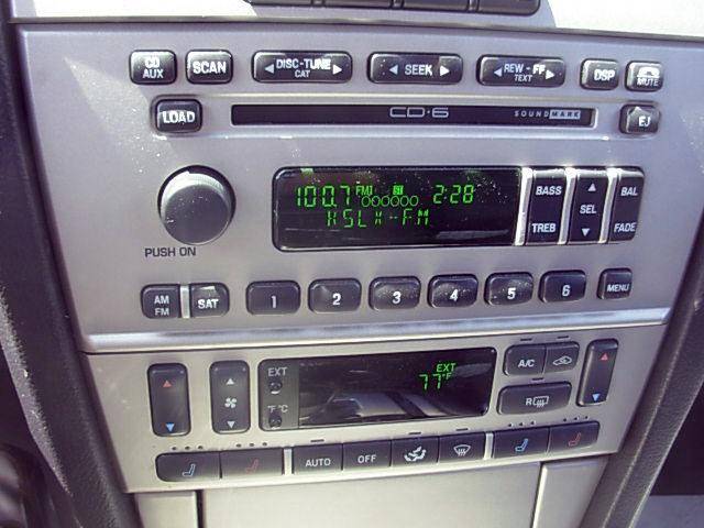

I just purchased a pre-owned 2004 Lincoln LSE that has the Sirius radio option installed in it. It didn't come with any manuals or info for the Sirius
radio operation. Does anyone know the best way to obtain the esn # or where to get a manual. I might add this car doesn't have the navigation option. Thanks for any help

oh and i know before i activated my sirius, if i had it turned on, it would only play a default welcome station and display the number to call, and the esn under it to activate it. try hitting your sat button and see if it scrolls across or displays at all.

Thanks for all the suggestions on my inquiry, and I really appreciate your
compliments on my new LSE. I finally got the sirius "esn" to display on the
receiver-by pushing the SAT button and the preset one button at the same
time. Had to play with it a couple times, and it finally work. By the way, this
forum sure shares a lot of good information. Thanks again......
