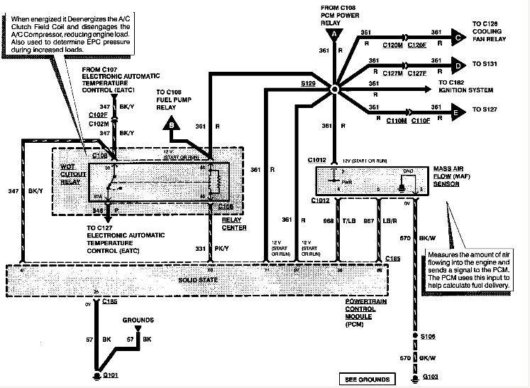

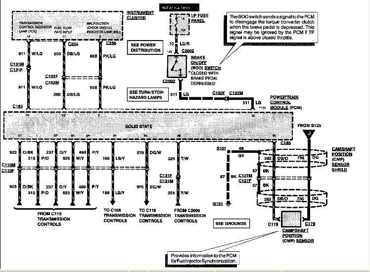

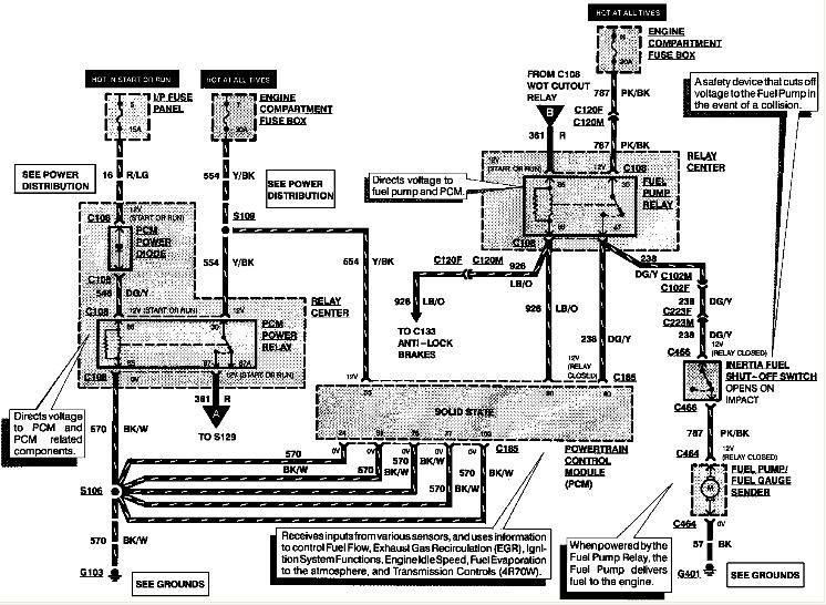

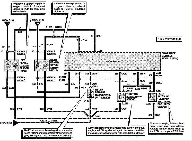

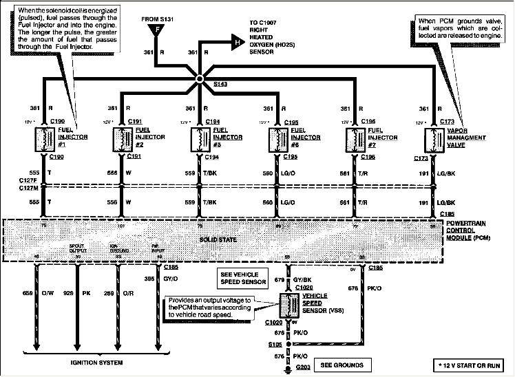

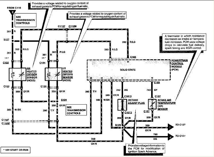

No thoughts on this? Any where I can find a wiring diagram to start checking the wiring?
wiring diagrams
hope these help, sorry about size. Its the best I could do.
Wiring diagrams for the 95 Town Car (Engine Controls)
