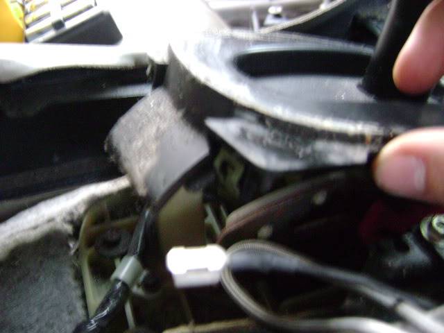

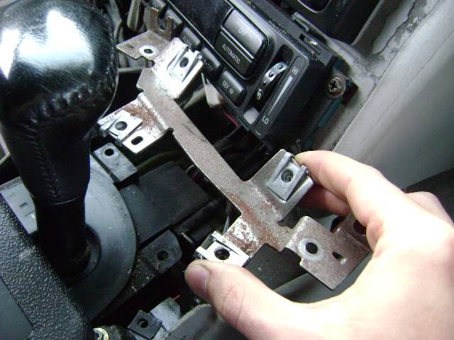

I forgot a couple steps. The easiest way to get it out is to remove that metal piece in front of the shifter.

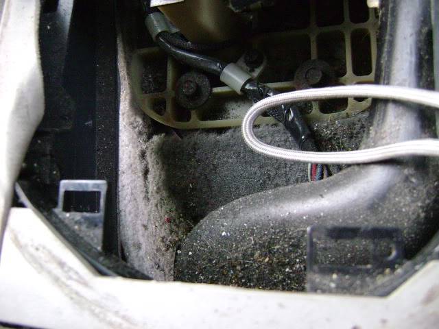

Then remove the 2 clips at the back of the shifter. I totally forgot about them. :D
