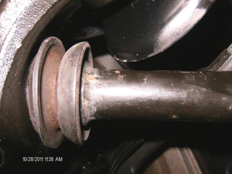

This one is suspension related. Over the course of 3 years I've replaced every front suspension part on my car. The only thing I haven't touched actually is the rear subframe bushings (I think). The steering rack is actually new also.
My car has twice sat for over 6 months at a time so I can't pinpoint when the problem I'm about to describe started happening but it was after the upper/lower control arms were replaced on front. Since then I've replaced everything else on the front.
The main problem is the alignment. The car pulls to the right and wears out the front left right(passenger side) on the outside quickly. Even after having it aligned at the best shop around it still is out of alignment. Since this started happening I've replaced the front strut bushings, outer/inner tie rod ends/sway bar end link (these are new actually). The mechanic last time I had the alignment done said (as he twisted the strut rod's inside their bushings) that they should not move. He also asked if when I changed the bushings if I had swapped the left and right strut rod. I honestly don't remember but aren't they exactly the same?
Ok, so also. I'm suspecting the left upper control arm to be loose or bad or something. I just put new roters on and when I hit the brakes and make the front end dive down I hear a creaking on the right? I just though about this today. I remember I inspected the boots just a couple weeks ago and they looked good so I'm wondering if there is a way to see if the thing is bad. Also, could a slighly loose upper control arm on the left cause the right wheel to wear?
