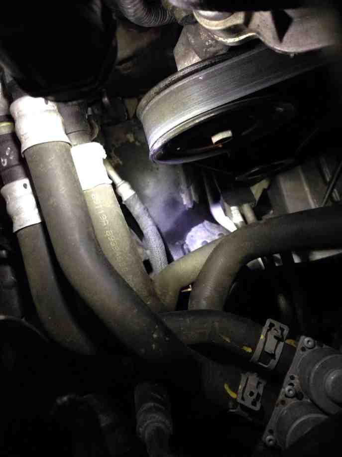

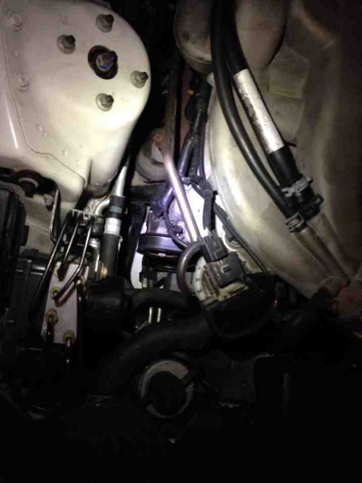

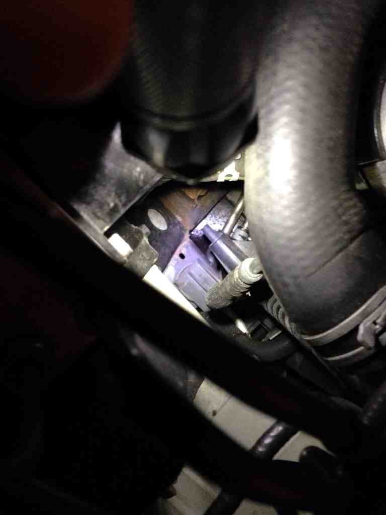

Further inspected the red fluid leak, here are some pictures. Have no idea what to make of this and there has been no more leakage on the white towel since the original discovery this morning on the garage floor.
This is the area where he pics are coming from
Here you can see where it's trickling down (dark trail)
Right here seems to be near where the source is located. Below the black cone type thing sticking out dead center is wet. More or less soaked there for lack of better words.
