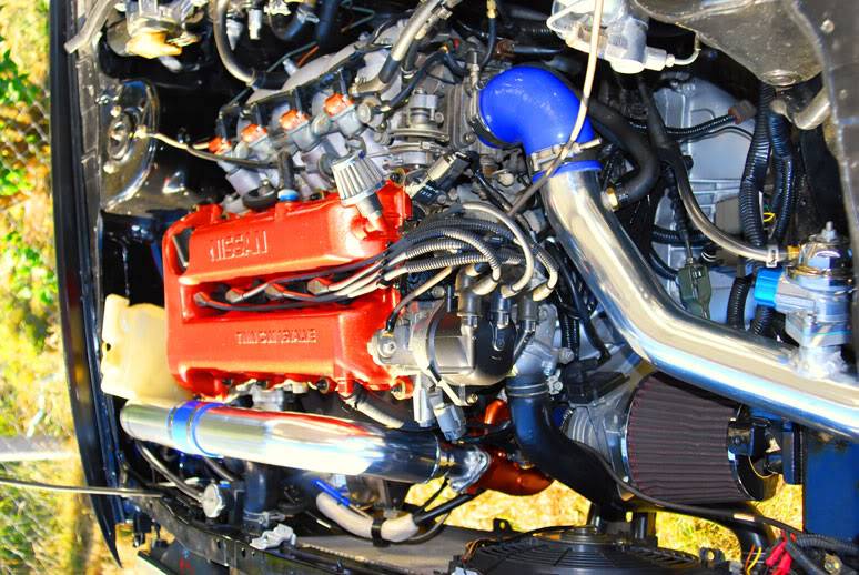

What turbo Nissan do you have, 240sx or 300zx?
I have a turbo 200sx SE-R
