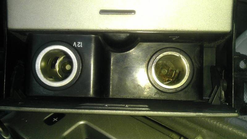

The plug on the right works, plug on the left doesn't. Checked fuses just to be sure (even though one works) and everything's fine. Checked with a multimeter and I've got power both in the socket and in the plug. However, power at the socket itself seems wonky. If I check voltage at the center of it, I get anywhere from 4V - 9V or so. If I check towards the outer edge, I get 14V. Why are the two sockets a different design? Or was one of mine replaced with some ghetto sh it at some point?
And why am I pulling 14V from these? Shouldn't it be 12V?
Left one is the good one, right looks corroded:
