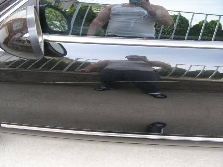

towards the side mirror the scratch is a little deep, but the rest i believe its a 'mar' type scratch as you put it...if i were to take it to a body shop how much would it cost more or less?
:) LOL that pic looks like a carnival mirror :D makes you look BIG and WIDE :)
I see white which means its deep good luck and sorry :(

hey fordnut, i hope ur some kinda motivational speaker or operator at a suicide hotline...cuz u sure give me a heluva lot of confidence about my apperance...lol. My friends nicknamed me "JUICE".....dunno why. lol

that scratch is real deep, It could easily be touch up, I have touch up many of those up at the body shop. i say take it to a shop have them touch it up, color sand and buff it.

hey mannieg, how much do you think a scratch like this would cost me to fix? considering your expertise on the topic?
I would say about 300-400 bucks, Assuming who does the job preps it right and blends the paint right. The labor is not so hard the costly part is the matching the paint due to the fact that they have to do a color match and black is one of the hardest colors to match.
