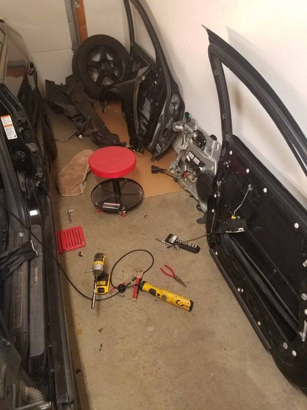

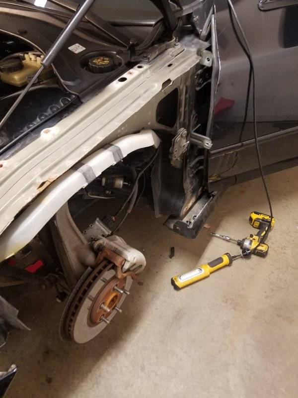

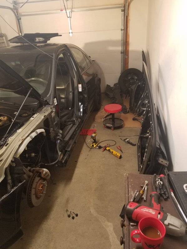

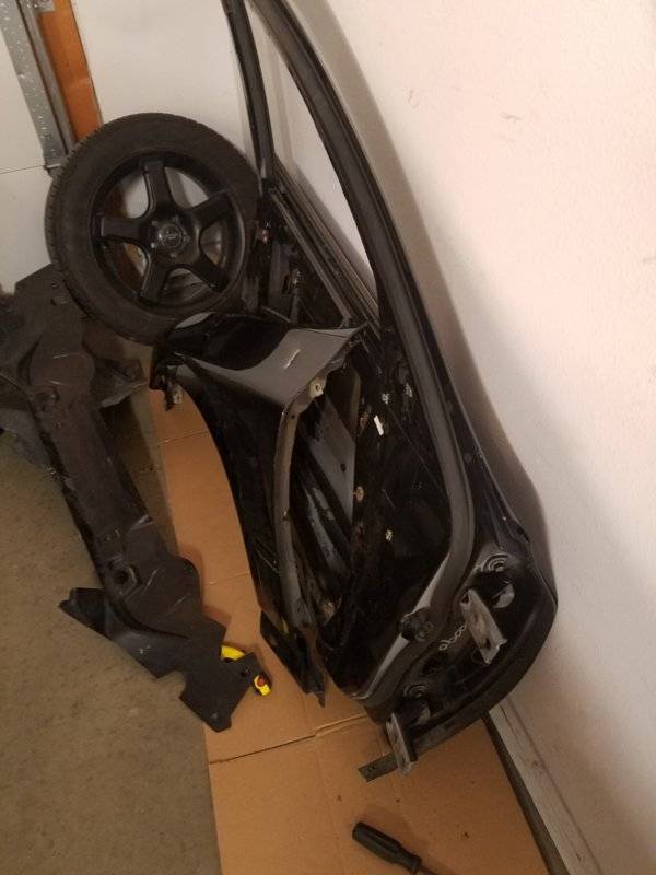

Does anyone know if I need to use my existing door handle and lock and latch?

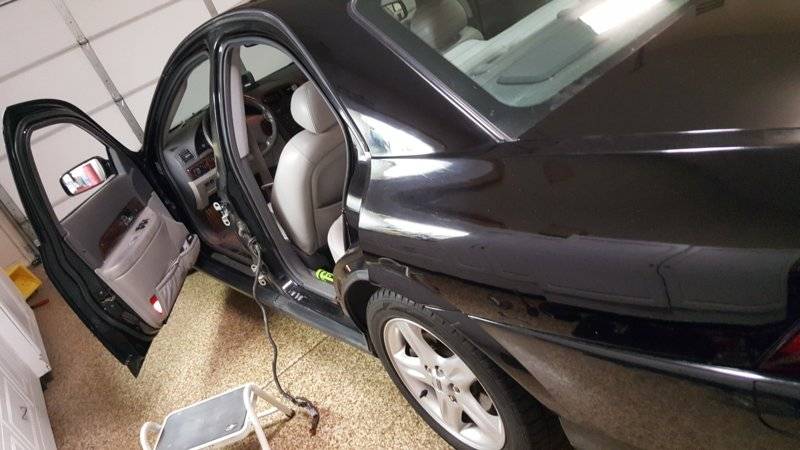

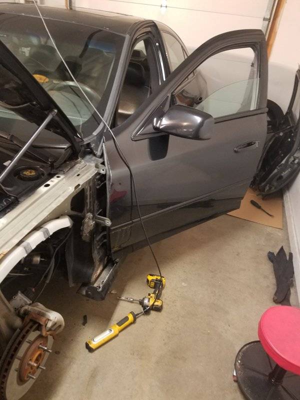

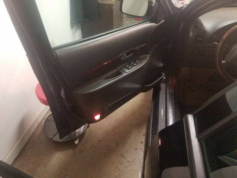

  • So far this is what I did to my existing door...the new door is up against the garage wall ...just a shell removed the interior trim panel (screws in the door pull, under a cover; and a couple of screws at the bottom of the panel...the panel itself is held in place by "bullet headed" push pins...carefully but firmly, pull on the panel until they release), and water shield, which allowed access to the lock mechanism. I then removed the door handle from the outside of the door, by removing the two retaining nuts from inside the door (11 MM hex). Then release the actuator rod from the latch assembly by pinching the ears on the plastic retainer that secures the rod to the latch lever. Set aside the handle.
  • Next remove the 3 Torx head screws from the door jamb that hold the latch assembly to the door, and also release any clips/clamps the hold the wiring/actuator cable to the door frame, then remove the latch assembly from inside the door.

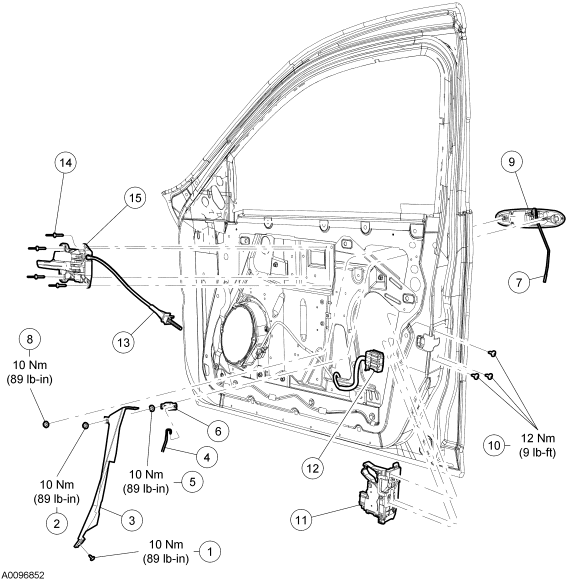

2006 Lincoln LS Workshop Manual
It's #6 on this diagram.
What joe said. The tumbler is what the key goes in to. It's part of the handle assy. So an easy swap at the point of disassembly your at. The latches etc can all stay. Just make sure you swap over the door control modules as I believe they are married to the vin/programmable.
Okay I figured it out ...you both helped me figure it out....Thanks!
