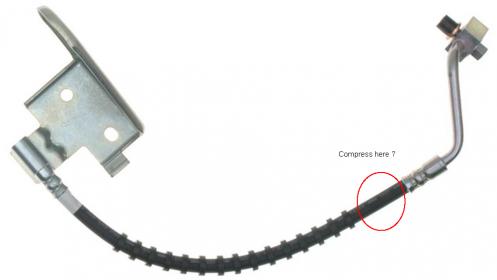

However, the brake line looked a bit stiff and I'm not sure if compressing the rubber brake line won't crack it. Perhaps that's just being unnecessarily cautious.
Is the circled area below where the line should be compressed ?

I've seen videos of people doing that.
After removing the brake line from the caliper, should I clean off the end of the brake line with brake cleaner and cover it with a plastic bag ?
Anywhere on rubber line is ok , stay couple inches away from metal. I have been doing this for 30 years no worries. After you remove banjo bolt from caliper line take it and remove the copper washer on it. This first copper washer likes to stick to the banjo bolt. Sometimes I have to knock them off. Won't hurt cleaning hose end ready for reinstall. Remember copper washer on banjo bolt then that bolt goes into caliper line then another copper washer.
