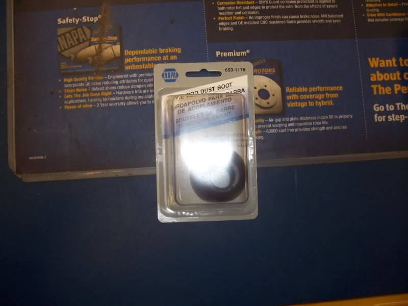

Does anyone know where to get replacement ball joint boots and what the part numbers are? The uppers on my '97 are split. I saw some in the HELP section but they either look way too big or too small.
I got them at NAPA I don't think they where HELPs. I think they where in clear plastic on a yellow/blue cardboard?
I need one for my P/S upper ball joint too. I'm going by Auto Zone after work today to see if I can find something that will work. I don't want to have to buy another UCA if I can help it.
I have used these and where the best fit I could find. I do have TRW uppers so I don't know exact fit on stockers but can't see them being that different. I'm pretty sure I checked HELP's and could not find what I needed but the stores I go to just might of not had them. I found these at NAPA for 5.39 each. They are sold as TIE ROD BOOTS.

Not sure what brand they are, but mine are not stock since they have grease fittings. I will check out NAPA for those boots.
