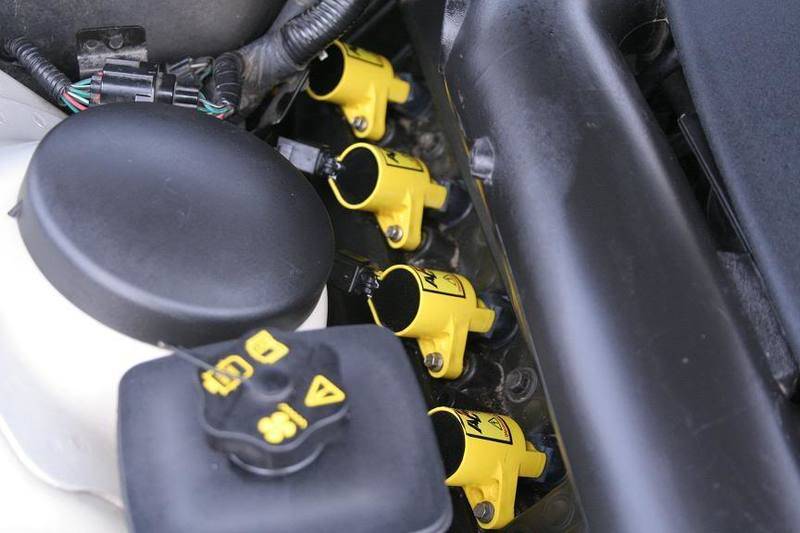

Nothing "better" than oem. No reason for "performance" coils. I run Accels, because they were about 200 a set from summit:
http://www.summitracing.com/parts/ACC-140032-8/

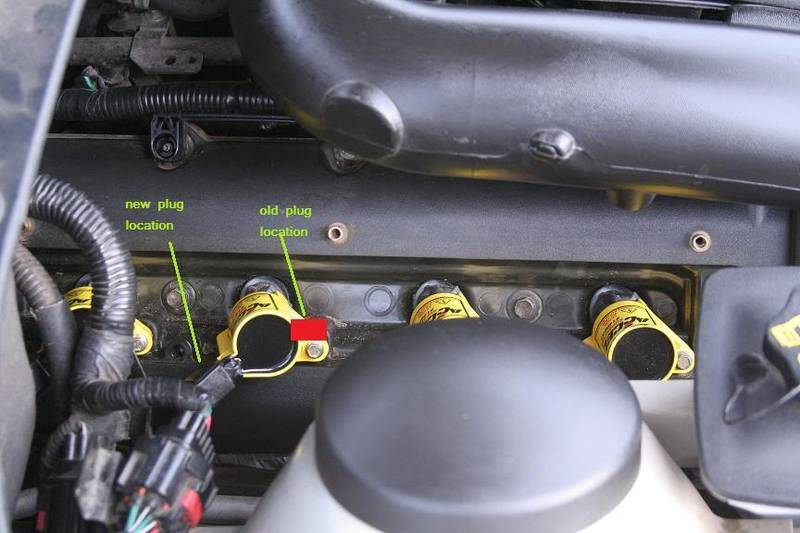

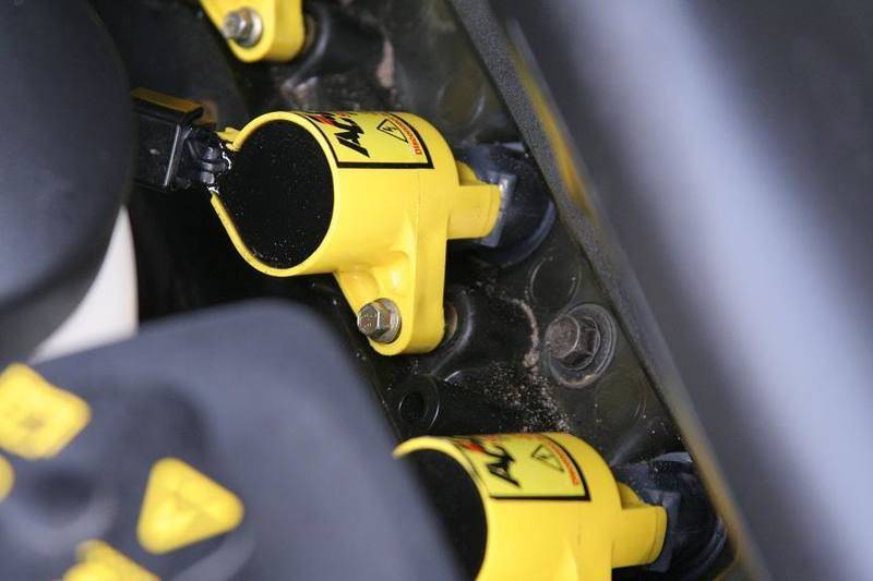

You cannot reuse the coil covers, because the accels are higher, and the location of the plug changes to an area outside of where the coil cover would - cover. This is how it will look afterwards:
thanks guys not sure if i want the accels or if they make something better but... looks really good nice pic thanks
