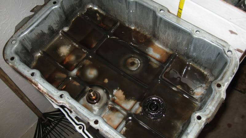

Well I replaced the solenoid pack because thats what the majority of people have said to do for my 1744 code. Welll after 5 minutes of driving check trans and E came back up. I should have replaced the valve body while I was in there.

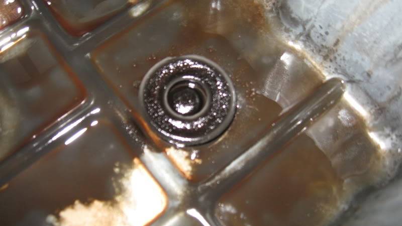

My fluid seemed pretty darn dirty for 65000 miles. Here are some pictures.

As for the pan, it is dirty, but not too bad or anything I would be real worried about.
