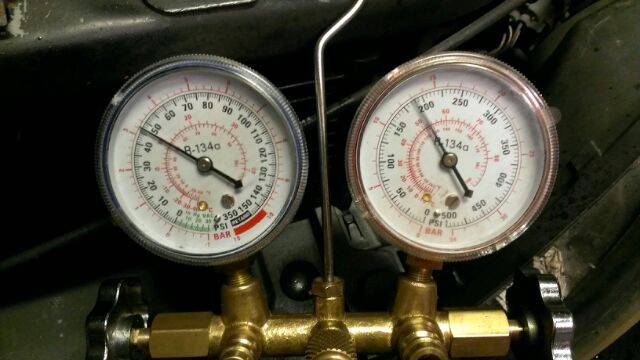

A. I went put more refrigerant into it thinking the same thing, and the gauges showed good pressure.

Proper diagnosis of the problem requires both a high and low pressure gauge set. In fact, you should never add refrigerant without monitoring the high side pressure too. Too much refrigerant is even worse than too little. Anyway, this is one of those "if you have to ask", then you should seek a professional. In this case, a good Ford/Lincoln dealer is your best bet.
I have the high and low side gauges. They were both where they were supposed to be. I bought the car from a private owner so I don't have the owners manual.

What were the high and low pressures and what was the outside temperature?
