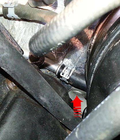

You talking about this hose cammer?
... When the new bottle goes in, your going to find that feeding the lower hose (already attached to the new bottle),
underneath the Brake Booster, is prone to want to go underneath the Steering Shaft Knuckle (at the firewall) due to the angle.
I used a long stick about 3 feet in length guided down from near the front of the Coil cover,
pointing towards to the Intermediate Steering Shaft Knuckle at the firewall ...
... helped in pushing the lower hose upwards overtop of the Steering Knuckle.
Using the cable-style spring clamp compressor makes that job pretty bearable from the top. Just get the head of the tool on the clamp, squeeze, pull the hose. The U-shaped hose picks also help. Also a good idea to replace that hose when replacing the bottle.
I've done it twice, and honestly it's just not that difficult (with the right tools). To me, the trick is to leave the hose connected to the degas bottle and just disconnect/reconnect to the pipe on the firewall. The OEM bottle comes with the hose already attached. If you are putting the Dorman bottle in, then get used to doing this...

The most bothersome part, to me, when I started in the first place, is that the end of the aluminum tube is way down behind the wiper/transmission assembly. And my degas bottle came with only enough hose attached to reach from the bottle---in place---to where it must be forced over the end of the aluminum pipe. AND NO ROOM FOR YOUR HANDS. (More later)

Hose pliers and hose clamp pliers.
(Alternately, it's not that hard to remove the wiper assembly.)
Actually, Joe, you put your finger squarely on the answer. I didn't count the number of bolts, but I'm now at the point of taking the wiper assembly out of the back seat and re-installing it. The only other problem in the hose/tube situation was that the tube had developed a small crack just beyond the end of the hose and just before the adel-type support hanger. I managed to get a long screwdriver in the right place and moved the adel so there was room to reinstall the hose..
Everything is now hooked-up and bled and the gauge holds rock steady in the middle after a ten-mile-or-so trip. Now to put the wipers back in place and start the task of drilling-out the broken bolts that hold the cross-brace on the tops of the springpockets and the firewall.

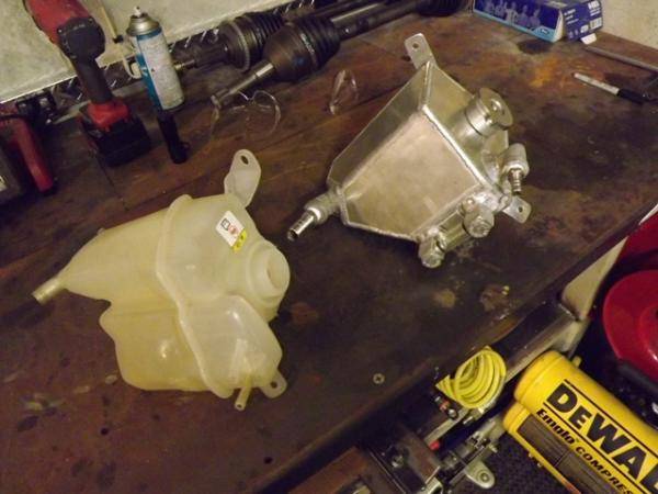

I did some research to find out what others have done when faced with the combination of engine and radiator placement such that the fill point must be located other than on the engine or rad. Race vehicles use a pressurized tank and although it could likely be made to fit, race car parts are offered by those who are VERY proud of them. But there are many manufacturers who make small metal containers that might be re-purposed easily enough. I'll keep looking!
KS
I like the idea of making a metal one, but you need one that mimics the stock version including all its passages and compartments. I pressure tested my setup at 15 psi and at least the motorcraft one didnt deform nearly as bad as the dorman one. That fatigue is most likely the main failure mode. If the plastic was thicker and it had better internal supports, they'd probably outlast the rest of the car.
And speaking of rust, the top of the wheel well where the splash guard push pins are suppose to attach rotted through on me. This allowed the frontward area to collect sand and hold moisture forever. Cleaned it all out good but need to patch it up.
Seems like for the long term someone's going to have to engineer a better replacement for the LS' degas bottle other than chinese dorman's crap. For how much the OEM one is going for I bet someone could make and sell one that's properly made. Who knows, perhaps there is a metal tank out there that is close enough that it could be repurposed.
