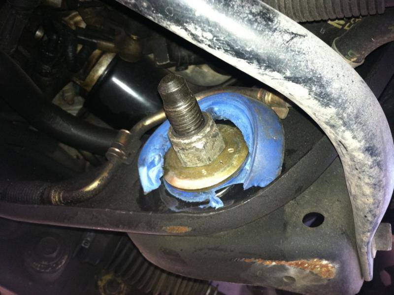

When working on suspension and steering wheel parts in the wheel well, should anything be marked to maintain alignment ?
Make sure your steering wheel is straight. Mark or measure you tie rod ends if your removing them. Mark your cam bolt washers.
I also took a lot of pics of everything. Your going to need an alignment anyway after your done.
My cam bolts were in a different spot when I was done just because everything was new and that's what I needed to do to keep the tires pointing straight. Then off to the alignment shop I went.
