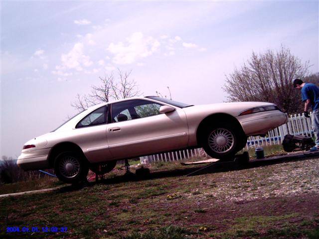

yeah,i swapped my tranny on a lumpy stone driveway (grass)too,it wasnt as easy as having a garage floor,but it can be done,i did the entire removal and replacement with absolutley no one else helping,so trust me it can be done.
And i am a small guy to boot.

That pic was great... see there is plenty of room under a Mark VIII...
Just get ready for the Tranny bath... Unless you have a drain plug in your tranny pan.

Thanks for the pic, Mike. It's very encouraging! How tall were those jackstands by the way? My jack and stands only go up to 21".
