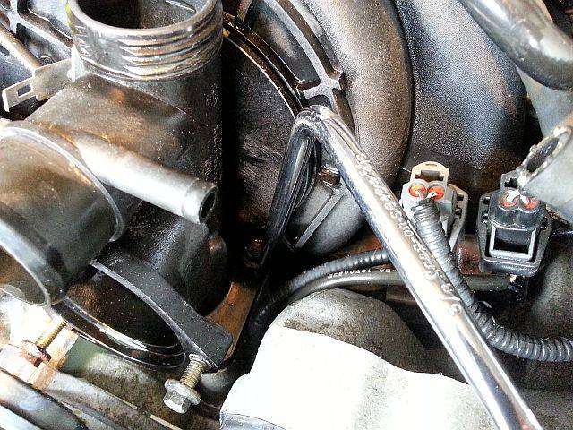

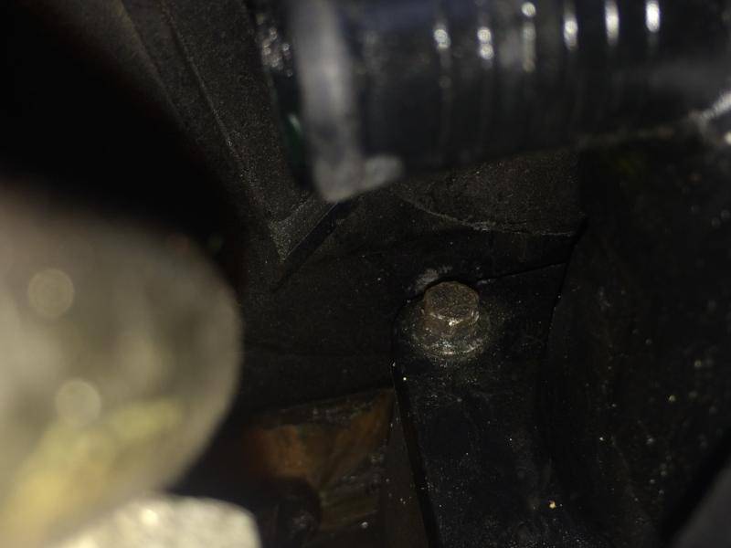

the bottom rear bolts of the housing seem impossible to get off, a wrench is too long and you cant get a ratchet or ratchet extension onto a socket even if you're lucky enough to get a socket onto it. has anyone used any tricks to remove these bolts? IMG_1557.jpg
If you can weld or know someone who does you can make a tool to work. Cut off the open end of a wrench and weld a 1/4" wratchet extension to the wrench section. Thats what I did.
thanks joegr thats exactly what i need! replacing this plastic trash with the jaguar parts.

Per the bolt, 1/4" extension with a wobbly end if I remember right from when I did mine. Wasn't that hard to remove with basic Craftsman quality stuff. Just don't round it off more or you'll really be pissed about it.

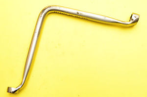

Tool you need is called a 3/8 -5/16 Brake Bleeder Wrench.
http://www.ebay.com/itm/LOT-340-SNAP-ON-TOOLS-S8184-3-8-5-16-BRAKE-BLEEDER-WRENCH-/201048264840
two back bolts can be shortened a bit to ease re-install.
