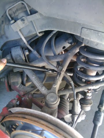

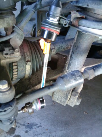

1. what the driver's side link looks like

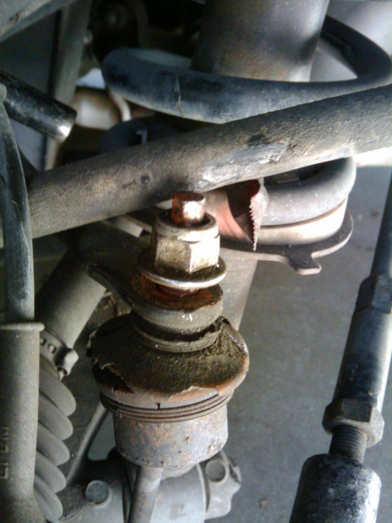

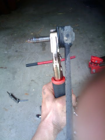

2. place the 15 wrench on the nut

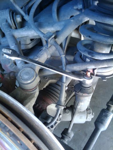

3. place vice grips right at the end of the screw. if this screw part moves, then your vice grip is not tight enough. try moving both hands inwards at the same time to loosen nut (righty-tighty for the vice grips, lefty loosy for the wrench)

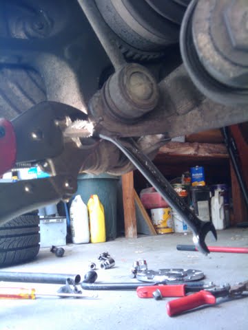

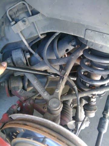

4. you can place a metal rod where i placed mine after you have loosened the nut. this will release the tension on the nut and will allow you to screw off the nut by hand. make sure someone helps you if you can't multi-task, or else that nut might come flying at your face.

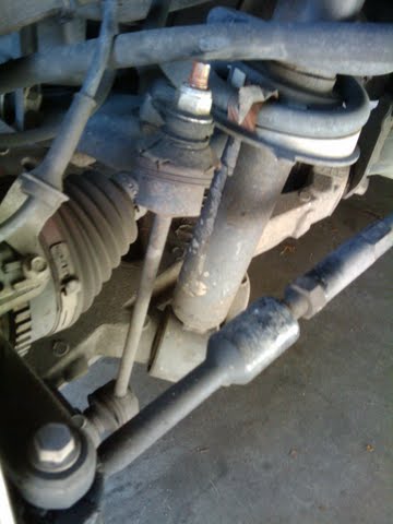

5. this pic just shows when i used the metal rod to help unscrew the nut.

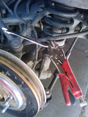

7. if you happen to be having an extremely difficult time with the bottom one as i was due to the tip of the screw slipping, use your vice grips to grip the screw at the place shown. use some WD40 to help you out

check out the very first pic. the were super cracked up and were all dried up. you can visually tell they were in need of replacement.

i use a 1/4" drive 7mm socket and wratchet to hold the suspension shafts instead of vice grips. they just scar up the steel but if you are changing the parts it doesnt really matter much. the front links are the same way. the ball joints too. does it ride better? i need to do my rear links as well.
you are right, and i knew that they would scar up going into it. since they are getting replaced i really didn't care. i can't tell you if it rides better since i didn't give it a test run, i'm still sick and when i finished doing:

I remember having to remove the links to get my Eibachs in, I used an air ratchet to get the bolts off and didn't have to hold them at all, it was only after I'd broken a 1/4 drive ratchet trying to hold the rod still while wrenching with a #15 that I tried the air ratchet.. If you have access to one, go with the AIR first. Makes life so much easier.
