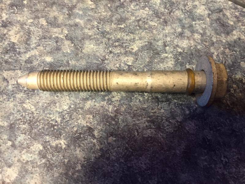

Not exactly a generic hardware store bolt...
Is that a 'trapped' washer? Where does the step on the bolt ride? Is there an obvious need for the lead on the end? Is it just the light or do the threads seem to be the sort that interfere as a locking device?
KS
Yes, the threads do seem to be that way. That would explain the one-time use. I'm not sure what the o-ring is for yet, or what the step is about.
The sort of thread shape I'm referring to is not quite the regular peak-'n'-valley sort that we are all used to. I believe there are several ways they mis-shape the threads so as to be forced into a regular nut or tapped hole. The mis-shapenness makes for a mild interference fit that doesn't require a Ny-lock but, in function, does about the same thing. The sort of Ford rocker arm that was used in the FE engine line had that sort of thread on it. After several adjustments the screw would become loose enough to require a new screw with a more mis-shapen thread. After that, you were on your own. (You CAN use a lock nut but then you have to spot-face where the nut goes.

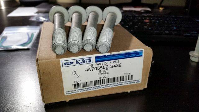

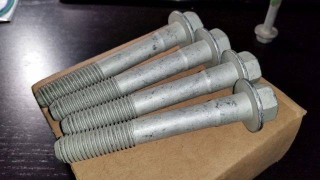

Joe, I have the following in stock, if it helps you any.
I originally picked these up for my 01 V8 when I redid the entire suspension BUT never ended up using the lower bolts.
http://www.fordpartsgiant.com/parts/ford-bolt_-w705552-s439.html
The numbers are W705552-S439 which were supposed to be for the lower shock bolt, M14 X 98MM
I do see in comparison to your pic, it does in fact NOT have such a rubber ring near the top of the head.
Not sure ... up to you ... LMK if interested.
