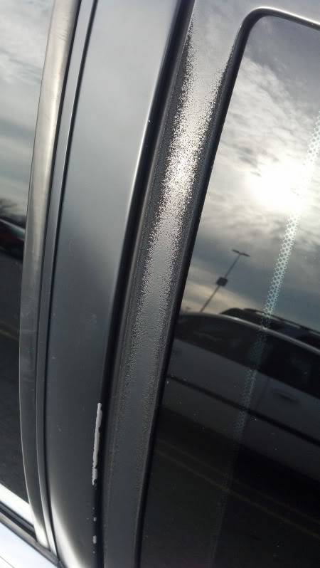

Nov 19, 2012 #1 Epwillis Dedicated LVC Member Joined Jun 19, 2012 Messages 547 Reaction score 35 Location Dearborn Heights, Michigan Anyone ever try to use plastidip to fill in their worn trim?
Nov 19, 2012 #2 K keVIIIn Dedicated LVC Member Joined Nov 9, 2011 Messages 2,432 Reaction score 118 Location Chi Just find another 1/4 glass from the jy with non faded plastic..they aren't difficult to remove from what I've read.
Nov 19, 2012 #3 Markviiiedrea Speed Bump Joined Sep 20, 2004 Messages 4,743 Reaction score 168 Location Bloomington, MN I have those things all over my garage, give ya a good price on it. or The whole glass is easy to pull, then just tape off the window, bondo the area to fill in the rash and paint it flat black.
Nov 19, 2012 #4 Sapperfire Dedicated LVC Member Joined Dec 4, 2009 Messages 6,645 Reaction score 173 Location Waco Don't need bondo.. high build primer will work
