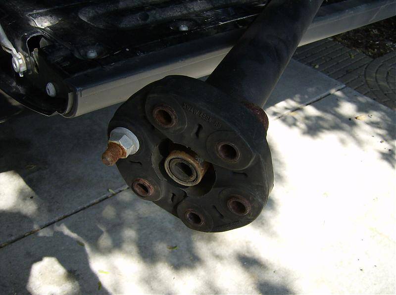

Well there is no u-joint at the rear connection, driveshaft to diff. The pilot bearing in there does little but keeps it centered and shouldn't wear as it spins at the same speed as everything. If the Flex coupler was trashed then I could see that getting trashed but I haven't heard of it yet. It does look like a replaceable part but never tried to remove it.
